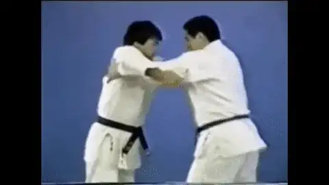

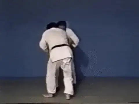

Just to add to MattM's answer, here is how the Kodokan Throwing Techniques video illustrates the difference in the sweeps in the two throws:
Technique Characteristics Example
Yama-arashi - same side eri grip
- off-balancing uke forwards
- standing directly in front of uke, sweeping upwards
- leg parallel to uke's
- legs almost fully in contact
Harai-goshi - standard collar grip / under-arm grip
- off-balancing uke sidewards
- standing across uke, sweeping across leg
- leg almost perpendicular to uke's
- legs in contact only at one point
