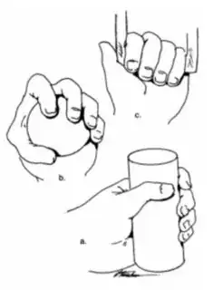

Fig.1 The Three Types of Power Grips: and judo examples
From the previous figure we understand that in judo
  • Cylindrical power grip (a) is the most common.
  • Round power grip (b) is applied by Russian style on the back, or during Sode Tsuri Throws,
  • And Lifting power grip (c) is applied during the obi grip.

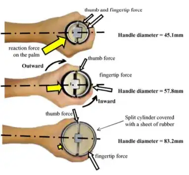

A recent study on the torque and grip forces on male and female cylindrical power grip, has shown that maximum grip forces is applied with minimum cylinder diameter.
Fig.2 different diameters forces applied
