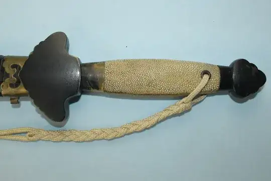

The short of it: they originate primarily from theatrical conventions of Chinese martial arts practice. However, what they may be representative of are historical jian lanyards which often are adjustable with a bead or loop and have tassel-like ends from the frayed cord. Historical jian on occasion do have holes in the grip for lanyards to secure the sword to the wrist like this very famous example from the Metropolitan Museum of Art: enter image description here And there are some examples of historical presentation jian with tassels like this one: enter image description here It wouldn't be that far of a stretch for the functional lanyard to evolve into the ornamental tassel over time for the modern performance aspect of Wushu and other Chinese martial arts. So originally the function of them was to secure the sword to the wrist, but now it's mainly ornamentation. Also a bit of niche benefit to them is that they add an extra weight to the end of the sword that can sort of counterbalance the entire weapon when it's swinging around loosely, but that's honestly a minor benefit if any. :P
