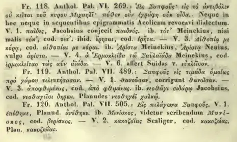

Bergk
Bergk p. 636 ha all epigrams, his line 1 reads:
Παῖδες, ἄφωνος ἐοῖσα τότ' ἐννέπω, αἴ τις ἔρηται
and he has this critical note:
Bergk's critical note for the epigram

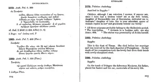

Whoopsies! I missed them in Campbell because they were in smaller font. p. 113. Et voilà: good morning ποτεννέπω, though Campbell agrees on the vocative. Here is a screenshot of all the epigrams in Campbell:
The three epigrams in Campbell's Sappho edition
