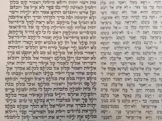

Vowels in Hebrew - called n'kudot - are written as dots and lines surrounding the letters. In an actual Torah - written on parchment - these symbols aren't there.
As an example, here's a picture of a book called a "tikkun", which is used to help learn the chanting for the traditional way to read the Torah:
description below
On the right side is text with punctuation and vowels. You'll notice that there are dots and lines and other symbols surrounding the text. (Along with the n'kudot is the "t'amei mikra", which show the traditional chanting tune.)
On the left is the text as it appears in the Torah. There is no punctuation or vowels. (You'll notice that there are symbols on top of certain letters - these are called "crowns" and are decorational for the most part.)
