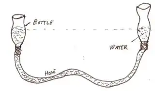

Level based on bottles and a hose
A much better level requires a little more equipment: two clear bottles, a hose and some tape to join it all together. The base setup is like in the image below:
Two bottles connected through a hose with water
To make this you cut off the bottom of the two bottles, and join them to the hose using tape. Fill up from one end until you have water appearing in both of the bottles.
This arrangement will have the water stabilising at the same level. If you have a few friends helping you, you can measure distance from the water level to your floor and decide what is level.
Another option using this level is to use it close to the wall, and mark on the wall (i.e. using tape which can be removed afterwards) where it is level, and then measure out the floor at different points.
Or you could use a tripod and fasten one bottle, measure the distance down to the floor, and then move the other bottle around and measure the difference of distance to the floor on different locations.
Added: Extended usage example
First of as Zaaikort indicates, you can also use a (semi-)transparent hose without the bottles as the level. In my experience though, it is a little easier with the bottles.
One way to 'calibrate' the system is that you attach one bottle (or that hose end) to a chair (or stick) and make a mark on the bottle at the water level. Hold the other bottle next to it and make the mark at the other bottle as well. Make a note of the length down to the floor from the water level.
When you now move the loose bottle around in the room, you can measure the distance from the water level and down to the floor. If it is not the same as the original distance (from the chair/stick) to the floor, you are not level and you can subtract the two values to see how much it is off.

  • Thanks. How do you actually used the second method in the sense how do you play the bottles on a surface? – Celeritas Sep 28 '15 at 01:35
    @CeleritasThe bottles are not essential, just a more-or-less transparent hose will do the job.
    You could tape each end to a vertically held stick touching the floor. To calibrate the tool, first place the two sticks together on the same spot and mark the water level on each one.
    – Zaaikort Sep 28 '15 at 08:35
    @Celeritas You don't set the bottles on the surface of anything. This method is best when you want to check the level of something that's very long, longer than a traditional level might help with. I used the bottle-less method in the past to make sure a drop ceiling I was installing was level across the length of the room. It required 2 people, but with one holding each end, we marked a line on the wall next to the water level at both ends at the height we wanted. From there a straight chalk line between the two marks gave us our level line across the length of the room. – wootcat Dec 10 '15 at 20:32
