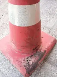

We have some short and tall traffic cones. Some of them are out of maintenance, and need to be repaired & cleaned. The two big questions are:
  1. How can I clean the traffic cones?
  2. How can I repair the traffic cone's white bands?

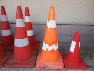

They look like this:
traffic cones
As you can see, there are three types of traffic cones, from left to right as defined 1, 2, and 3. Number 1 is dirty; number 2 is both dirty and damaged; number 3 on the right is short and repaired temporarily.

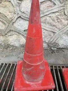

dirty traffic cone
You can see the dirty cones contain oil, dust, etc. and need to be cleaned. Which product should I use without harming the plastic surface and it's colour?

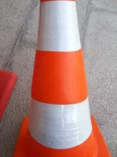

repaired traffic cone
To be clear, I bought a thin reflective band in order to surround the cone, but according to the geometric rules, if I use a rectangle sided band on a cone, I will face some material gaps that I don't want. Also, the problem is that bands are very expensive here in Turkey.

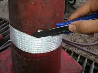

Here is my current solution. First of all, I cut every old and dirty reflective sticker with a utility knife:
Now it looks like that:
I used a green roughed dish sponge with Cif Cream to rub, and cleaned with water.

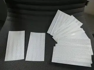

I bought large reflective rulo from an advertising banner shop in the city center, then I cut it into lots of rectangular pieces. Each has almost the same length & width:

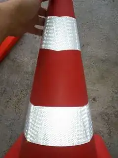

After that, I put these pieces onto the cleaned surfaces of the traffic cones. While I was doing this, I needed to force the surface inside to attach the sticker correctly on to the straight side. Even though the surface is cone shaped, when I forced the material inside and under, thanks to the surface's flexible material (not all, just some of them are soft), it performed as if the area was flat. I put the sticker on smoothly with ease:
You can easily see when you are near the cones, I had unwanted and unneccessary corners when we put the stickers on. I used a utility knife to modify all corners in order to look good.
I know that these methods are not original. According to the traffic safety, I must clean and repair these old traffic cones.
