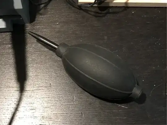

Compressed air is perfect, but I have spent one can just cleaning one PC thoroughly. Now I use a dust remover for SLR cameras (you can buy one cheaply in any store that sells such cameras), and it works for all heatsinks etc. It doesn't have enough pressure to do it from 15cm, but that's never an issue. I only use compressed air for keyboards now.
Camera Dust Remover
