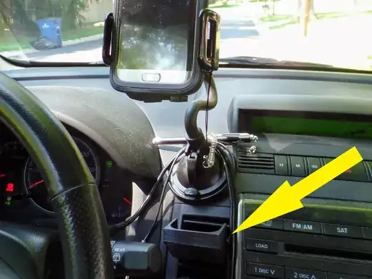

In the end, I designed an air deflector and 3D-printed it, as shown in the image below.
If you think it'll solve a similar problem that you're experiencing, you can buy one from my shapeways store. I plan to add it to my thingiverse page soon as well for those who have their own printers.

  • How is your mount attached to the dash? It does not look smooth and flat enough just for a suction mount. Is it glue? – zerkms Dec 23 '17 at 22:27
