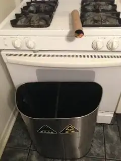

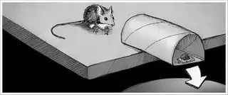

There is a simple trap you can make with:
  • empty paper towel / toilet paper roll
  • trash can
  • peanut butter
Instructions:
  1. Put a small dab of peanut butter on the inside of the roll on one end.
  2. Place the roll so that the end with the peanut butter is hanging over a counter (balanced over the edge)
  3. Place the trash can underneath the open edge of the roll.
  4. You may need to glue a small weight on the end of the roll depending on how short or long it is to act as a counter balance.
The idea is that the mouse will smell the peanut butter and try to reach it through the roll. It has enough balance to stay by itself, but once the mouse reaches over the edge, it and the roll will fall into the trash can.
Leave this out overnight to allow ample time for said mouse to find the trap, and collect in the morning.

    As a mouse rescuer, this is the best method I've ever seen! I have a few additional suggestions. Mice can die of shock or stress, so it's important to keep them comfy in the bucket. Line the bottom with paper towels or a dish towel, to cushion the fall and keep them from slipping around. Also add some crumpled up paper towels, or a small washcloth. They'll burrow under and feel safe. If they're young, or will be confined for many hours, place a small amount of water in a jar cover or bottle cap in the corner of the bucket. Finding them dead after caring so much is heartbreaking! – Sue Saddest Farewell TGO GL Jun 23 '15 at 20:32
