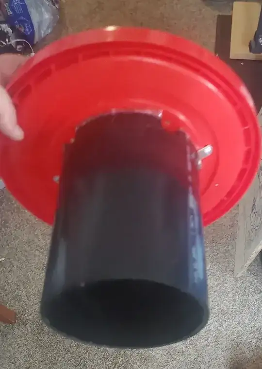

Also you want the air to skim across the cold Ice/water So I agree with most of the comments I will make it clear that if you are trying to cool off anything bigger than a approx. 10' x 12' room you are definitely going to need it to be insulated so if it 108°F outside and your garage is 115-120°F YOU BETTER GO FROM LITTLE TO HUGE! So what you need to do is get a good fan one that pushes some air. More like a blower is best. Anyway channel the air down and force it directly at the ice/water. Leaving only 2-3 inches between the cooling source and the bottom of the air funnel. But be sure that you have enough airflow to let the fans motor do its job at optimal efficiency. So go with 4x1.5" or 2" if needed or you will burn the motor out quick as shit. The blowback from the air not being able to escape freely is a lot of the problem that people don't even realize. That said once you do this it will drop a 12'x12' insulated room 10-20°F really easy and quiet quickly. Crack a window just about ¹/²" and let the hot air be pushed out of the room also for about 5-10 min. Mix sugar with the water ( Sugar? Yes sugar ) and freeze it. If you have a block of ice put it in the bucket cover the top with about 1/2-3/4 of a cup of sugar. Sugar will make it melt more slowly than hot water, cold water, and salt. I know most people never heard of putting sugar on it just salt. You always can look it up and make sure if you want to. But I have been doing a lot of homework lately and I've been impressed with how much colder the temp dropped and for how much longer. 1st test temp coming from the 2x 1¹/4" ports was 55-62. Then i added the funnel and 2 more x 1¹/4" holes= 4x1¹/4 and it dropped the temp coming out to 36-44°F. When I added the sugar onto the Ice alone it dropped the temp down to 24-28°F consistently and lasted 1¹/2 longer than just ice or ice with salt.
