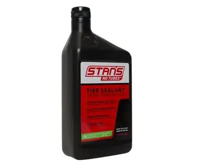

Another option (admittedly not a life hack) is to add tyre/tire sealant to your tube. This is a white liquid latex-based goop which goes in after you remove the valve core, and then sits inside the tube. If you get a puncture while riding the sealant is supposed to bubble out the hole for a few seconds, then harden and seal the leak.
One of the well known brands is Stans, http://www.notubes.com/Stans-Tire-Sealant-Quart-P51.aspx and while its intended for tubeless tyres, does okay in tubes too. Note it only stays effective for months, then you need to add more. Also, this stuff is sometimes called "stans jizz" so just call it "sealant" if you don't want a ribbing from, your riding mates.
Otherwise replace your tubes, they're only a couple bucks each, and the dead tubes/valves can be used for many other things.
