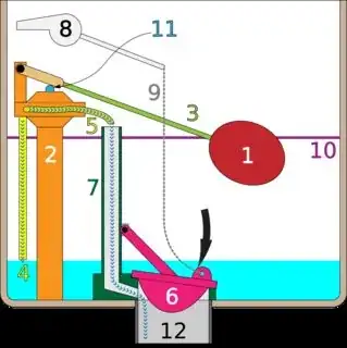

I found it hard to find a good picture of a reservoir. This one from wikipedia isn't great but it will suit.
Toilet reservoir source
Most toilet reservoirs look similar to this. The actual parts may vary but the function should be the same.
You have a swimmer (1) which will "tell" the toilet when it's full, by floating on the water, releasing the pressure knob 11 when the favoured water level (10) is reached and thus stopping the filing of the toilet.
If you drain the toilet by flushing (8) the stopper 6 opens to let the water urn out. With this, the swimmer goes don, pressing on the button (11) and refilling the toilet. If you put extra water into the reservoir it will fill, until it reaches the opening next 5. Any more water will drain through 7 into the toilet.
Therefor in a standard toilet, there is no risk in overfilling the reservoir.
BUT: Please note, that water tank from different sources can be filled with a lot of minerals (not in the case of a dehumidifier, since it's nearly distilled water) or microbiological contaminations. These can grow in your reservoir, producing a biofilm which will start smelling/ be unhygienic etc. So please have an eye on the cleaning schedule.
