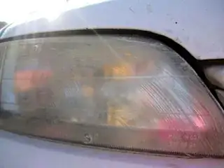

My car is getting rather old and it's headlights are foggy and dirty. How can I possibly clean them to be as close to new as possible?
Car headlights

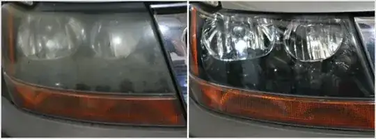

The image above is what I'm chasing.
EDIT: I know of the toothpaste method and I'll be attempting that today, but are there any other methods people know of to achieve a clean headlight?
