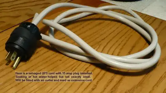

enter image description hereRe: Make stiff cables flexible again. One technique used for replacing stiff lawnmower tires is to soak them in hot water until they become pliable. This also works to a degree on detached foreign made power cords. Cords attached to electronics can be heated with a hair blower but this takes a lot of time and electricity. Another possibility I have not yet done is to lay the cord on a hot asphalt driveway during summer. But, this runs the risk of UV light destroying the plastic jacket. No one method seems to work 100% due to the chemicals used in plastic manufacturing. I think the objective is to get products out the door as fast as possible with little regard to usability.
