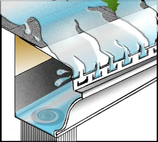

gutter guard animation
This looks awesome, but I don't know how easy it would be to DIY. Maybe just a few long pieces of wood? Just an idea.
Consumer Reports recommended DIY ones, such as 'CR Best Buy Amerimax 85198 or 854054,' which they say costs less than $100 and is available at Home Depot for $2.50 for a 20' roll.
Hope this helps!
