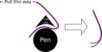

One of my co-workers saw me struggling with this problem and pointed out that our labelmaker has a special tool built into the plastic next to the cutter. You stick the end of the label in and pull hard, and it curls the end of the label around and makes the two halves separate.
If yours doesn't have this feature, you can achieve the same thing with a pen and its cap: Put the cap on the pen, slide the label between the pen and the clip on the cap, curl the label around (so it makes a U-turn around the clip), and pull hard. This forces the label and backing to separate at the end, and you can then easily pull them apart. (This works best if the clip is fairly close to the pen; a standard Bic ballpoint is perfect.)
Diagram of above explanation
You can also buy labelmaker tape where the backing is split along the center, so you just fold in half lengthwise and it comes apart.
