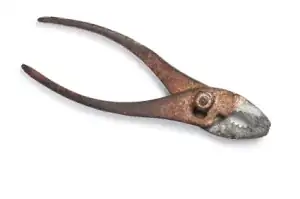

I accidentally left some tools outside for a few days while I was away and they rusted. I can barely use them now. They were good tools, and I don't want to have to buy new ones. Is there any way to get the rust off of tools and return the tools to close to the state they were in before?
