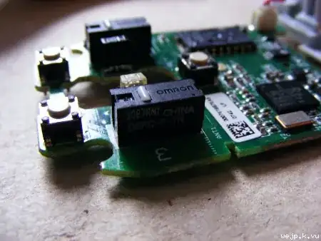

I have a wonderful mouse except... I'd like it to click more silently (left and right buttons). Probably it was that loud, probably it is the work of Time, but the current sound doesn't suit me now, especially at night.
Any ways to reduce this sound?
I also have a trackpad, which have no clicking sound (I can just tap), but I find the mouse to be more useful and convenient to use. Please don't recommend buying a new mouse or another device.

Two options:
  1. Use a thick foam mouse pad. Using a mouse on a hard desk will amplify the sound.
  2. Take the mouse apart and insulate around the click switches (see image). Felt, or thin foam would suffice, but the key is to maintain the function while adding something to dampen the sound (Disclaimer: I have never done this!).
Image of click switches where insulation is needed
As a third more drastic option, you could try and replace the click switches with ones that are less noisy. Most likely more trouble than it's worth, and I can't actually provide a product/catalog # for ones don't make a sound.

  • Good options, thanks. Still, I'll wait for another options to arrive :) – nicael Feb 21 '15 at 16:05
    Covers all the options I can think of, except using a noise generator to conceal the noise. – subjectivist Feb 21 '15 at 17:57

You can open your mouse and apply few drops of oil (which is non-conductive) on the click mechanism, it should do the job.

I put chewing gum around the tiny switches inside the mouse. I think it lessened the noise a little bit. Can fill it p with some kind of foam later. Hope this will work for you too.
