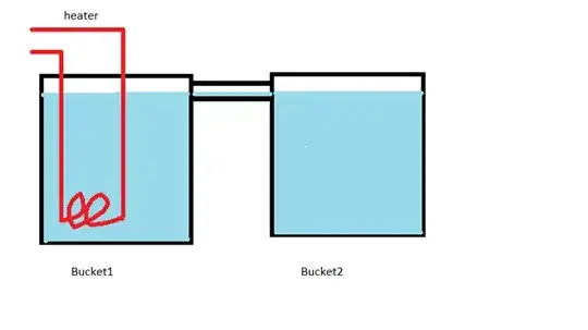

I think that the image will clarify your question connect two bucket via a tube. It will exchange cold and hot water in the buckets. The result is that both buckets of water will get heated.
- 555
- 3
- 14
Connecting the buckets makes one (weird shaped) bucket from the two and begs the question. – Stan Jul 20 '16 at 15:56
Without a second connection at the bottom, to enable a convection loop, this won't actually work over any reasonable time frame. You'll get a thin layer of warm water in the second bucket, no more (absent stirring the indirectly heated bucket and waiting a long time). – Zeiss Ikon Oct 05 '16 at 11:39
