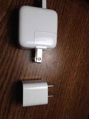

The iPad charger will charge your iPhone faster than the iPhone charger that came with the phone.
The iPad charger puts out 5.1v at 2.1 amps.
The iPhone charger is 5v at 1 amp. ipad and iPhone charger
The larger of the two is the iPad charger.

  • Have any evidence for this? –  Feb 13 '15 at 16:28
    My own experience. My phone charges significantly faster with the iPad charger. It outputs at higher amperage so that it can fill the iPads larger battery quickly. – Doug Watkins Feb 13 '15 at 16:33
  • Yes I have found this! And my iPad would take over a day to charge on a small charger (I know that's not really safe and it could blow up but hey ho) – MrPhooky Feb 14 '15 at 10:08
  • On trips I only lug around the iPad charger. It halves the charging time and works on all devices. – oligofren Jul 03 '15 at 13:43

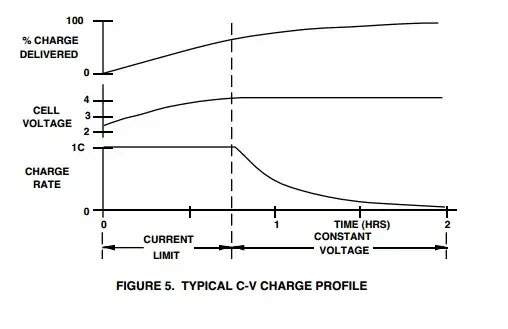

Something else to take into consideration, not really mentioned in any of the other posts, but does affect how fast the phone charges: Even if you had a charger capable of delivering as much current the device was wanting to draw, there is still a limit on charging speed that boils down to how Li-Ion cells charge.
Most cells are happy (And by happy, I mean not-catching-on-fire) to be charged at somewhere between .5 and 1C, where C is the capacity of the battery with the units mangled. For example, my phone has a 2600mAh battery. Ideal charging rate would be somewhere between 1.3 and 2.6 amps. However, Li-Ions are also very temperature sensitive, which can lead to the not-happy fire scenario mentioned before, so most charge controllers also limit current when temperatures get too high. In most cell phones, I imagine the charge rate falls more towards the .5C range of things due to temperature constraints.
Now, on top of all that, that's not all. The .5-1C charging is only good for about 70% of a Li-Ion charge cycle. Li-Ions also do not like going much above their rated voltage (somewhere around 1% or less, I think), and the voltage on the cell will rise as it charges, eventually reaching 4.2V. Once that point is hit, the charge controller will hold the voltage, and decrease the current, which is shown on the dotted vertical line on this picture.
This is the reason why it always seems to take forever for your phone to charge for that last bit (I'm not exactly sure what drives the recharge rate in the constant voltage section of charge. I'm sure fun electrochemical stuff).
So, the takeaway from this is your device will only charge so fast, regardless of how much current you can supply it.
Source: http://www.ti.com/lit/an/snva557/snva557.pdf
