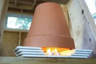

So my first guess was to use the tea candles or some heating system in which tea candles heat a combination of ceramic flower pots, but according to some article, they're too impractical (not to mention the indoor air pollution issue).

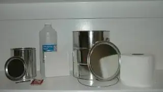

Something similar to your tea candles solution would be toilet paper roll, rubbing alcohol and an empty paint can (as explained here). I actually saw this method in a video some time ago, but can't find it anymore.
Steps to take, to make above mentioned things into a heater and even a stove:
  1. remove the cardboard tube from the toilet paper roll
    1.1 you can either cut the cardboard with a scissor or peel the cardboard where it's stuck together, like this young man explains, and then pull it out.
  2. squeeze the toilet paper into an empty paint can (you can also use two toilet paper rolls, if your paint can is big)
  3. fill the paint can to about 4/5 with rubbing alcohol
  4. light up the toilet paper
The toilet paper functions as a wick, so all the rubbing alcohol will be burnt. Also the paint can will stay cool in the lower half, so you're still able to move it around.
Stove:
To turn your heater into a stove, simply place three bigger paint cans (or any other heat-proof objects) around your heater. Now you can put a Pot on top and you're ready to go!
