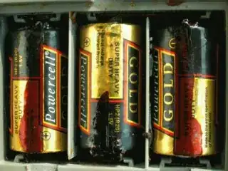

    My personal experience has led me to never buy Duracell brand batteries again. Once upon a time, they made an excellent battery. But nowadays, almost every leaking battery I see is a Duracell battery. Other brands of batteries, stored or used in identical conditions, are not leaking. – End Anti-Semitic Hate Nov 20 '20 at 05:23
    @RockPaperLz-MaskitorCasket I don’t know what to buy now, since I’ve had Energizers leak recently. The same Energizers that they advertise as having a “no leak guarantee”. That guarantee only gets you a coupon towards the purchase of more Energizer batteries. – pacoverflow Dec 31 '20 at 06:41
    @pacoverflow You gotta love meaningless "guarantees". I switched from Duracell one-time use batteries to Eneloop rechargeable batteries for almost all of my electronics. It's been several years, and not a single leaking or dead Eneloop battery so far. :) – End Anti-Semitic Hate Dec 31 '20 at 07:48
    @RockPaperLz-MaskitorCasket Oh I should try that then. I have a bunch of Eneloops lying around. I wonder what cases there are where an Eneloop would not be an acceptable substitute for alkaline. – pacoverflow Dec 31 '20 at 08:54
    @pacoverflow Although exceptions may exist, Eneloop rechargeable batteries have worked excellently in all applications I have tried. My use of non-Eneloop batteries is 9V batteries for smoke detectors. Eneloop does not currently make 9V batteries, so I've been looking for something good for smoke detectors (preferably rechargeable). I read a report that Amazon Basics 9V batteries have a history of exploding, so those can only be used in an environment where one is okay with their electronics exploding... thus they are useless & money lost. I doubt Jeff Bezos will give us all our money back. – End Anti-Semitic Hate Dec 31 '20 at 18:25
  • @RockPaperLz-MaskitorCasket At least I've read that 9V batteries don't leak, since they basically are just a bunch of smaller batteries contained in a rectangular shell, which would contain any leak from the interior batteries. – pacoverflow Dec 31 '20 at 19:37
  • @pacoverflow I would have to look through all my photographs of leaking Duracell batteries to see if any were 9V. I think I've had 9V Duracell batteries leak through the outer shell. I think 9V are probably less likely to leak than others (for the reason you mentioned), but not impervious to it. According to the report I read regarding Amazon Basics, their 9V batteries have a history of exploding, which of course, is even worse than and more dangerous than leaking. – End Anti-Semitic Hate Jan 01 '21 at 00:02

    Note that due to the potassium hydroxide in it, preventing to leak is impossible, you can just lower the risk. Especially the point about cheap batteries is important imho since the better ones have much better sealing that can hold for decades. I would also add to the list to never use batteries that might be physically damaged (e.g. been dropped, have a dent etc.). – PlasmaHH Jan 19 '15 at 13:47
    Would inverting one or more of the batteries achieve the same effect as removing them all? – Duncan Jones Jan 19 '15 at 15:33
    As to cheapness - I stopped buying Duracells years ago thanks to their apparent propensity to leak and destroy things. – Ed Randall Mar 15 '20 at 11:39
    @EdRandall I have had the same problems with Duracell batteries leaking. I no longer purchase that brand either. I have had expensive electronics damaged by their leaking batteries. – End Anti-Semitic Hate Nov 20 '20 at 05:24
    @EdRandall Energizer has the same problem even though they have a “no leaks guarantee”. – pacoverflow Dec 31 '20 at 06:33

My experience is: by spending more money on batteries.
The cheapest batteries of them all, zinc-carbon non-alkaline cells, always will leak. The zinc casing will be consumed and it's a fact of life that a fully consumed battery WILL leak. Also so-called "heavy duty" batteries belong to this category.
Slightly better batteries, alkaline cells, leak only because of a failed seal. By buying name brand batteries like Varta or Duracell, you can usually get a 10 year shelf life. It's rare for a name brand battery to leak before the shelf life ends, but since seals aren't perfect they may occasionally leak at a very old age. Even a fully consumed alkaline battery (that is not past its shelf life) doesn't leak because they don't have consumable zinc in the casing.
However, the best batteries of them all, rechargeable low-self-discharge NiMH cells, don't leak, at least if you only buy name brand batteries. Their voltage, 1.2 volts, is fully compatible with any device using primary batteries (that have a discharge from 1.5 volts to 1.0 volts). The only drawback is that the voltage characteristics of NiMH are relatively flat so any battery life meter will show them half-full for 99% of the lifetime and then the battery life meter will suddenly indicate it's completely flat and surprisingly the battery dies very fast. Also in devices using lots of power like brightest flashlights and camera flashes NiMH has far better runtime than alkaline. Only in very low-drain devices like emergency radios alkaline batteries can have longer runtime.
There are cheaper and better low-self-discharge NiMH cells. The best of them all are Eneloops (made in Japan, originally by Sanyo, now by Panasonic).
My approach is that I always use Eneloops during "good times" (whenever grid electricity is available). However, preparing for "bad times" (large-scale grid outages due to for example geomagmetic storms similar to Carrington Event of 1859), you probably want to have a large stash of single-use primary batteries for emergency lights and radios, or maybe if you live in an area where solar power is available during winter too you may devise a solution using solar panels that can charge the Eneloops. If you decide to stash primary cells, store the batteries in a container where leaks won't be an issue, buy only batteries having at least 10-year shelf life and never store them in any electrical device. Use them only whenever a geomagnetic storm or a similar event causing grid outages happens.
I have experienced cheap no-name NiMH cells leaking. I have never seen an "unprovoked" Eneloop leak even though I have ones bought in 2008 or 2009 that are still working fine and have over 90% of their useful capacity left.
I have seen a "provoked" Eneloop leak -- in this case, the leak was provoked by a cheap zinc-carbon or alkaline cell leaking and the Eneloop being stored in the same container so the corrosive fluids touched the Eneloop battery. I suspect this "provoked" Eneloop would have been fine if it was stored away from leaking cells.
