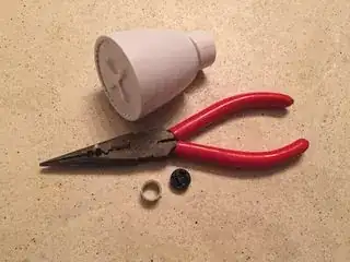

Remove flow-rate restrictors in the shower head
You can make sure that there are no water flow rate restrictors inside the shower head. These can usually be pried out (I've done this on hand-held shower heads, too; see also this video):
taking out flow rate restrictors with needle-nose pliers full size image
Or you might need to drill a bigger hole in the water inlet of the shower head (which I've done on larger shower heads).
