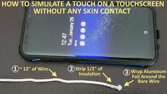

Take about 12 inches of electrical wire and strip approx. 1/2" of the insulation from one end. Now wrap the exposed bare wire using a piece of aluminum foil and flatten the end of the foil a bit. I quickly made one and took a photo to better explain it (see image below).
You can now use this to replicate your finger touching the screen.

    The contact area of the aluminum ball should have a diameter of at least 5 millimeters (7/32 inch) to make sure the phone screen actually recognizes it as a finger and not a random disturbance. That's why all of the passive (not battery powered) styluses have a wide tip. – Elmy Jan 28 '22 at 08:57
  • Great addition! I had a feeling it had to be a minimum width because a really narrow tip didn't work very well for me while testing it out. That's also why I said to flatten the end of the foil because I didn't know the precise specs. Thanks for clearing that up :) – nnamerz Jan 29 '22 at 23:40
