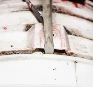

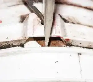

  2. Wedge a flat head screwdriver between the top edge of one bucket and the rib of the next. enter image description here
  3. Gently turn the screwdriver and wait a second for the pressure to equalize. enter image description here
  4. Rotate the bucket a couple of inches and repeat steps 2 and 3
After going around the bucket, you should be able to slowly pull the buckets apart.
