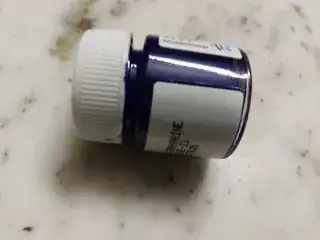

The acrylic paints dry out soon once they are opened. Adding water doesn't help because they become rather hydrophobic, rubbery in texture. Hence a lot of paint is wasted and one has to buy a new bottle. The bottle is made up of glass as shown in the picture. Is there any way to reuse them? Or any way to prevent them from drying?
What kind of container is the paint in? Can you show a picture? – Caius Jard Jul 06 '20 at 05:55
@Caius Jard I have added a picture. – Ojasvi Jul 06 '20 at 07:37
Have you tried storing them upside down? – Caius Jard Jul 06 '20 at 08:00
Yes. I have. But still they dry out after few months after opening. And same happens with other companies of acrylic paints. – Ojasvi Jul 06 '20 at 08:12

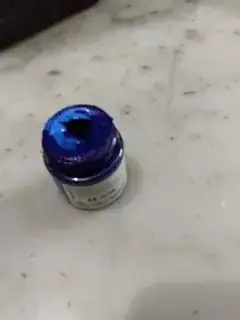

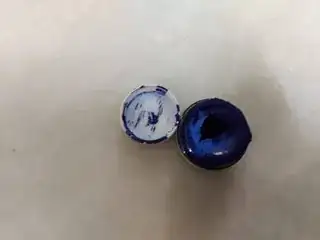

Can you open that bottle, set it upright on the countertop, set the lid upside down on the countertop, and photo it so we can see the mating surfaces of the seal inside the lid and the rim of the bottle? – Caius Jard Jul 06 '20 at 08:17
Added the pictures – Ojasvi Jul 06 '20 at 08:27

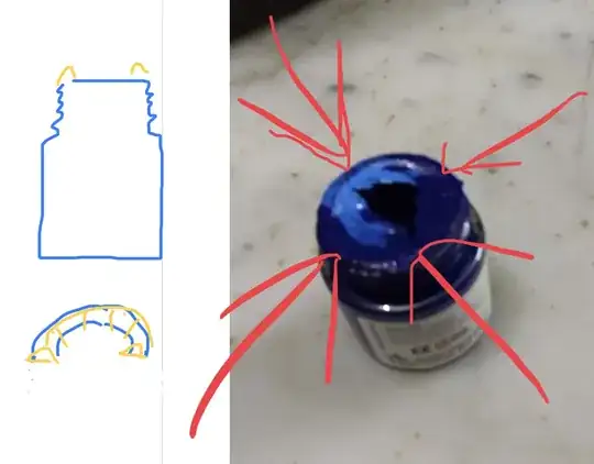

I think one of the problems here is that after use, the rim of the bottle and the seal in the lid (if you pick at the inside of the lid, near the screw thread edges, a round white squishy disc will probably come out) become contaminated with paint and no longer form a perfect seal to keep air from getting to the paint (or keep whatever solvent makes the paint remain pliable inside the bottle)
You may encounter better success/longevity if you clean the rim of the bottle and the lid seal scrupulously or, even better, consider using something like a small amount of petroleum jelly (or similar "easily squashed" but "can be cleaned off after opening, before it contaminates the paint" substance) to aid in providing a good seal when you screw the lid down. Clean the rim and inside the lid, then dab some small amounts of PJ onto the top of the bottle rim in a few places. Pinch a finger and thumb together and place them either side of the bottle rim, the thumb near the screw threads and the finger pointing into the bottle. Rotate the bottle, and the triangular shape made by your pinched digits should make a thin continuous bead of jelly all the way round the rim. Here's an attempt at representing it pictorially:
When the lid is carefully screwed down it should flatten this bead of jelly and make a reasonable seal even if there is some residual contamination like old paint. You don't need to tighten it it your fingers fall off, just gentle nip up should be fine

The lid in your picture does not have any seal, so air and moisture can slowly escape from the paint through tiny gaps where the lid doesn't fit the bottle perfectly. If there is a foam or rubbery disk in the lid when opening a new bottle, do not throw it away but place it back in the lid. That is your seal.
If there is no seal in the lid, you can try making your own. Place a piece of thin plastic foil over the opening before screwing the lid back on tightly. A piece of a freezer bag works very well, but cling film (doubled up) or aluminium foil do the job as well.
Alternatively, fill the paint into a clean container that is airtight. For this reason I always keep very small glass jars from spices or sauces. Their lids almost always have an incorporated rubber seal.
Always keep the lid and rim of the container clean. Old, dry paint can cause gaps in the seal or damage the seal if the paint glues the lid and bottle together.
