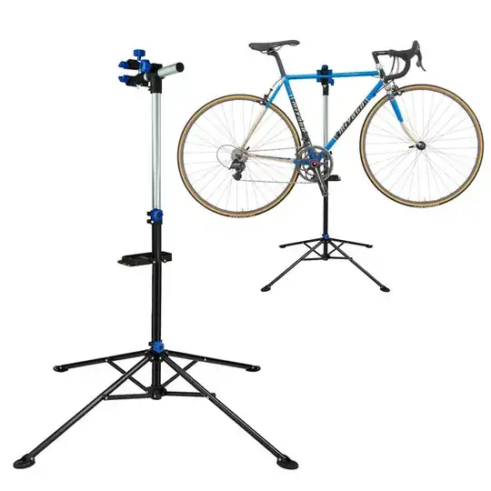

I'm looking for a hack, so I don't need to go somewhere to hang my bike or buy a work-stand like shown on the photo below.

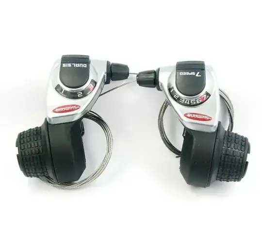

In this case I have the gear shifter round the steer with he indicator facing upwards, see photo below. Putting the bike upside down makes it hard to shift gears and I cannot read the gear position from the indicator.
So, putting it upside down is not the answer for me.

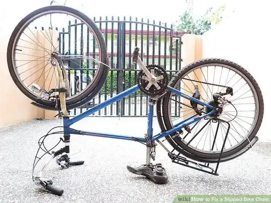

When I mend a puncture or do maintenance work on the chain, I just put my bike upside down. I do have a rather broad saddle; a racing bike might be a bit too unstable to stand still on its own. Still, you should have some other (moderately heavy) items lying around to stabilize the bike, e.g. by preventing the frame to move to either side.
Glorfindel
  • 1,040
  • I was thinking the same thing, but would that still allow switching gears easily? – BrettFromLA Jan 15 '20 at 02:30
  • If you use levers to switch gears, it's just a matter of remembering/figuring out which ones do what (for some reason I can't remember the orientation). It might be more difficult if you need to rotate one of the steer handles. – Glorfindel Jan 15 '20 at 06:45
  • Another downside, some parts of the transmission will change their response if gravity were reversed. Subtle fine adjusts like gear alignment might work well upside down and then be subtly off when right-side up. – Criggie Mar 18 '20 at 18:46

When I was a child I had a bicycle. Although I did not repair it in the common sense of the word, I needed to "things" to it occasionally. Special supports were obviously out-of-the-question. It was very easy to just turn in upside down, do whatever needed to be done, and put it back on the wheels at the end.
The most trouble was with the chain, which would slip and was occasionally difficult to lay it back properly.
The stability of the "turned" bike is given mostly by the width (length?) of the handles. The bigger, the better. They actually form a triangle with the seat. Ideally, the seat is not thin and rounded - in that case the stability might suffer.
My bike was the most simple one, with no gears and no breaks (I would press the pedals the opposite way for breaking). I had exactly the same issue, because re-laying the the chain required rotating the pedals, to rotate the wheels in the process.

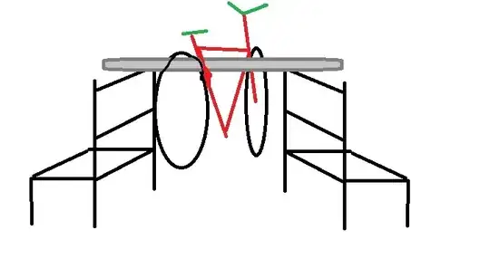

Forgive the poor picture, however depending on your furniture layout and type, you may be able to use 2x "dinning room" chairs and a broom stick or similar to lift the rear of bike frame from the floor.
Set the 2 Chairs / other pieces of furniture, on either side of your bike, run a broom handle or similar through your bike frame and rest on both chairs.
BikeFrame Broomhandle
Apologies.. my answer mirrors another answer earlier who suggested a "Hang"
TiO
  • 359

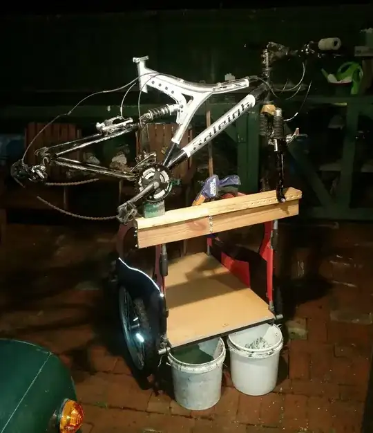

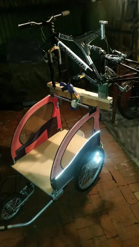

I had a need to fix bikes at local popup-fixup events. But to still be mobile, I carried all my tools on a bike trailer.
Not owning a stand was awkward, so instead of spending big money on a good one, or accepting a janky cheap stand, I made this:
Own work
Its a cheap kid's trailer, and a main beam that has two pipes underneath. Those pipes slotted into the handlebar's plastic brackets, so later I swapped those out for two steel seat posts I'd cut out of old steel frames.
The front wheel has to come off, and the front forks are held on to a length of threadded rod (allthread) with two nuts and a lot of washers, to allow forks of different styles and widths. Note this probably won't work well with front through-axles, but bolt-on and QR axles work fine. However tweaking front brakes has to be done off the stand.
The rear of the bike is cantilevered out the left-side of the trailer. This lets the drive train spin while its on the stand, necessary for fixing and tuning gears. An odd-shaped bike might not fit very well, and a heavy bike might cause some imbalance, so I leave my heavy spares boxes in the trailer. I also use a couple of buckets to take the weight off the tyres, and the drawbar is tied off to something immobile ideally.
Own work
