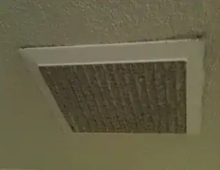

Bathroom exhaust vent is on the ceiling and quite difficult to reach as it exactly above the wash basin. I wanted to clean it up as it was dirty. I used vacuum cleaner and then wiped with wet sponge, but the result was not effective. I could not clean thoroughly and could still see the dusts on the inner sides. Any hacks for this without removing the mesh from ceiling?

The pic is really blurry. – J. Musser Dec 27 '14 at 13:18
@J.Musser I will replace it with a new one soon. – Joachin Joseph Dec 27 '14 at 13:24
has tried with a broom? – rnrneverdies Dec 27 '14 at 14:12
2You're likely not to get your best results without removing the cover from the fan, so you can clean out the interior better. – Adam Miller Dec 27 '14 at 14:17
These things really should be replaced when they get used this much. Keeping up old ones for a long time could lead to health risks down the road – Zach Saucier Dec 27 '14 at 14:23
I wonder if using a vacuum attachment on it may work, at least it would be easy. – CRABOLO Dec 27 '14 at 14:38
1Any reason for not removing the mesh from the ceiling? – apaul Dec 27 '14 at 22:10

Take a ladder, go up and use a toothbrush. Rub for some time and then rub with wet sponge. Do this until you clean it from the outside as much as you can and then use a vacuum cleaner.
I don't see very well what kind of cover is on the fan, but sometimes if you can't pull out the dust then you can try to blow it in. If your vacuum cleaner can't blow (I mean if it can't reverse the air flow) then use something else which produces air under pressure, for example a can with compressed air for cleaning computer keyboards.
