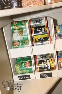

The simpler option, and what I generally do, is give a column to each type. e.g.,
| corn | beans | etc |
piled up within their column to the back of the shelf. But you can also make your own organizer:
There are instructions here, which take plywood (pieces for either side, and the sloped inside) and glue them together to create what you see above.
