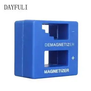

Beyond the great answer by Stan, there are actually a few tools that'll demagnetize things. Googling "demagnetizer" seemed to bring up a lot of good options, with a lot of places to get them, including the standard online, department, and home improvement stores.
You can demagnetize the tips of the jaws, but not the whole tool with this one.
Demagnitizer and magnetizer in one
You rub the tool on the outside of this block to demagnetize, if I remember correctly.
Alternate Demagnitizer and magnetizer
