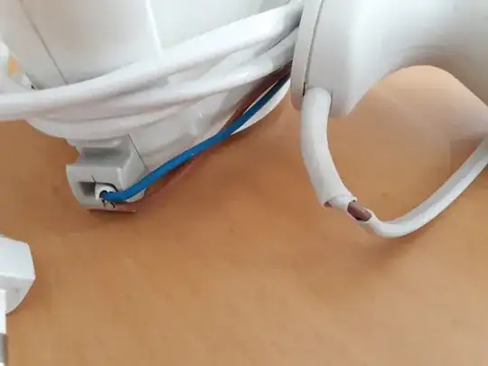

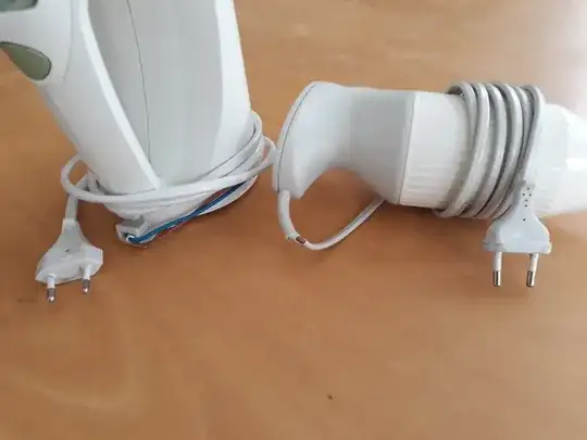

I usually store electric appliances by coiling up their cables. Unfortunately this causes the cable jacket and insulation to break long before any other part of the machine, rendering a perfectly fine appliance unusable.
Below are two recent examples. The break is always close to where the cable exits the hard-plastic casing of the appliance, and it usually appears within only a few years after I bought the product.
Cables of tools like electric drills seem to be made of another, more flexible material, and I haven't yet had one of them break, even after decades of use.
Coiled cable with damaged sheath
How can I prevent cables from breaking when I coil them?

You're rolling them too tightly. Cables have a minimum bending radius: get below this radius and you damage the cable.
Make loops that are at least 10 cm in diameter. This also applies to the bend where the cables goes into the appliance.
This also means you can't wind the cable around the appliance. Use Velcro cable ties to keep the cable together instead.

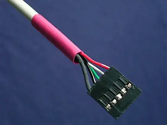

If you have a hot-air gun (candle or lighter might also work), you can use heat-shrink tubing for a new layer of insulation. Those tubes are cheap, much cheaper than sugru in any case... the main issue is getting the tube past the plug. So either you have to use a tube with a huge shrink factor, or just take the molded plug off entirely and replace it with a custom one that is meant to be user replaceable.
heat-shrink tubing
