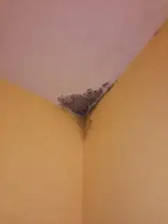

I have mold in the corner of my kitchen.
Usually remove it with mold-removing chemical products like bleach spray and it work perfectly. But recently some people told me these chemicals are harmful and I should not use them. It is very dangerous if you inhale the chemical while spraying. That is why I am asking you for an alternative non-toxic solution of this problem

You can use hydrogen peroxide in a spray bottle to kill the mold and then just wipe it away.
It is probably worth noting that the mold that you can actually see is very likely the tip of the iceberg. If you can see mold growing on the wall it is pretty likely that there is mold inside of the wall as well.
It is also probably worth checking your roof/plumbing for leaks, molds usually need a pretty damp enviroment. If you can find the source of the water you may be able to solve the problem for good.

The user Apaul34208 is correct. But since this is my job I must tell you that it is crucial to find the source of the mould. The source could be a pipe leak, roof leak or etc. There could be some serious problems behind the mould that need to be identified before the problem is resolved.
When it comes to just fixing mould problem none of those products cannot be harmful since you are not using it in the whole house or every day.
When and only when you find the source of the problem and fix it can you remove this using a reputable product, and when it dries you can apply acrylic based paint.

  • I forgot to write that I know why mold is there. It is because of condensing moisture. The ceiling of this room has no thermal isolation. Above it is the balcony of my neighbor. And in the winter the moisture from air is condensing in the corners, because the air is not moving much there. That is why I have to remove mold periodically and in the next summer I will put thermal isolation. – vladiz Dec 22 '14 at 09:01
  • Yeah,thats the most usual reason...Thermal insulation is only permanent solution....Until then you can scrap wall paint completely , that should slow down this process – python starter Dec 22 '14 at 09:30
