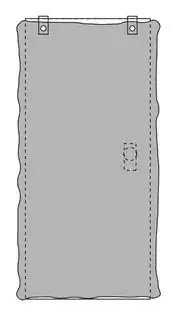

Next, You can try hanging mover's mats from strong portable over-the-door hooks
Overlap the opening on either side of the door as best you can. Keep the length sufficient to clear the floor as you swing the door open and closed. The mass of the mats and their thick multi-layer construction will block most all but the sounds by contact with the floor from composition shoe heels and similar objects.
You can take them with you as they're not permanent. You can wrap the mover's mat to protect your belongings when you relocate.
If you buy new, when you get to a more private place, they'll make fantastic warm blankets on a cold day.

  • Thanks. In fact I did not grow up in the US. Could you let me know by the way how much does it cost to have the necessary stuff you were referring to? Thanks. Of a normal quality suffices. – Yes Jul 10 '18 at 17:50
  • @GaryMoore Over-the-door hooks are less than $5 Canadian. The thick-heavy "moving blankets" are stock items from moving companies and truck rental agencies. They would probably be ~ $10 (72" x 54"). Online, they are for sale 6 for $60 Canadian, plus delivery. You might need more than one if they are too thin. – Stan Jul 10 '18 at 18:09
