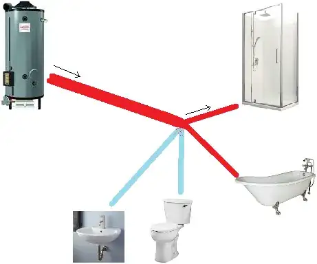

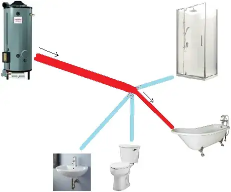

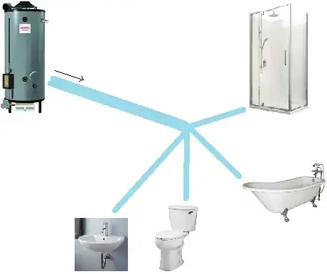

I'm pretty sure that all the water for your bathroom (shower, sink, toilet tank, bathtub) comes from the water heater to your bathroom in a single pipe. The pipe then branches off into multiple smaller pipes, leading to the various faucets / outlets.
This should mean that if you get hot water from the bathtub, the "main pipe" is now full of hot water. The feeder pipe to the bathtub will be full of hot water, even though the feeder pipe to the shower is still full of cold water.
But filling the shower's feeder pipe with hot water from the main pipe should just take 3-4 seconds, instead of half a minute.
My solution, then is to keep a bucket in the bathtub. Turn on the hot water tap, and fill the bucket. When the water coming out is hot, turn on the shower. It should become hot in 3-4 seconds, and you will only have wasted the tiny amount of water that was in the shower's feeder pipe.

    Your illustrations are getting better 'n better. – Stan Apr 09 '18 at 15:54
  • @Stan LOL I assume you're joking! – BrettFromLA Apr 09 '18 at 20:53
    @BrettFromLA No. – Stan Apr 09 '18 at 21:30
  • @Stan well then thank you! I'm happy with the shower + tub + sink + etc. clip art but those "pipes" I drew aren't terribly impressive! But ... it does convey my lifehack idea pretty clearly. – BrettFromLA Apr 10 '18 at 01:07
