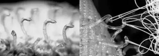

velcro ripper
While this image is supposed to illustrate the default mechanism of action for the velcros it also shows exactly what it does to knitwear.
