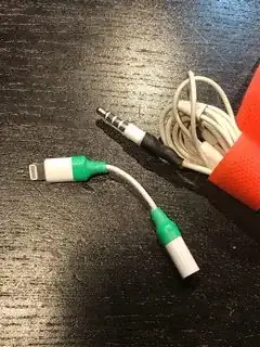

Use hot glue on the wire leading into the 3.5mm male jack, and stiffen it with 5-10mm heatshrink. The heatshrink will compress onto the jack and hot glue, making it highly tug-resistant.
foo
I have a pair of earbuds that have lasted 6 years after receiving this treatment.
Edit: It’s worth mentioning that the rubber on most earbuds will naturally decay in strength by the joints - they’ll break even if you don’t tug them.

  • wow. looks somewhat ugly because of color, but why dont they do it on-factory.... – Alexei Sosin Oct 13 '17 at 09:06
  • You can have any colour. Pink, if you prefer. It’s not applied anywhere but by the lightning/3.5mm jacks. Apple et al could protect earbuds better, but they’re a huge source of revenue. – user2497 Oct 13 '17 at 11:43
