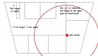

I have a project to boost a wireless signal but without touching the router and its antennae.
1st of all the router is above the cabinet which we can't reach.
2nd we are not allowed to touch the router which means we can't add extender or any other wires.
And 3rd we were asked to boost the signal in order to reach the targets and be creative. here's my illustration:
initial illustration

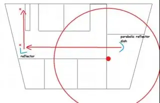

I am planning on using aluminum card board, foils and tin cans as reflectors and to save money. so I plan to make a parabolic dish and some reflectors made up of aluminum.
Can my dish reach the targets or my reflector(s)? I don't know how analog/digital signal works but i think it would bounce in a strait line when ever it reflect.
Here's my illustration: plan A
Plan A illustration

  • At my home, I have a reflector just behind the Wifi Router, so that it directs the signal in the right direction. I have another one which is placed in front of my desktop computer's wifi receiver, so that the computer receives a stronger signal. In your case, you could try the second one, considering that you can't touch the receiver. – Abhigyan Sep 17 '17 at 07:32
  • In many cases a reflector just makes things worse, creating multipath interference at the receiver (you have 2 signals coming in via different paths, arriving at the receiver at different times). – Hobbes Sep 21 '17 at 15:58

A reflector would be difficult to get right. A parabola at the location you've drawn does not help: it'll just increase the interference. A parabola only works if the transmitter is in the focal point of the parabola.
Making an antenna that runs on batteries isn't going to work either. You'd need to build a repeater. This is a radio transmitter, and you need a decent background in electronics to build one that works instead of making the situation worse. It'd be easier and cheaper just to buy a repeater instead.
