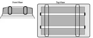

Best way would be to box the mattress so that it will not distort before you place it on a roof rack for secure tie-down as with any stiff package.
Second, minimalist method will be to sandwich the mattress between two boards (2x4s) one-third of the way in from each side for the full length of the mattress to prevent it from flexing. Secure the boards front and back to each other. Cover the assembly with plastic sheet (It might rain.) Tape the loose ends of the plastic sheet. Fasten it securely to the roof rack transport.
Mattress-moving rooftop sandwich stiffener

  • Big advantage of this approach: the boards will prevent the front end from "flipping up" in the wind as you drive. – BrettFromLA Aug 30 '17 at 18:19
  • the using wood pieces way would be how I would do this for such a distance. +1 – TiO Aug 31 '17 at 09:20

I like Stan's idea of the 2x4's, but I would still have the shibari so you can bind the mattress proper, and strap down the 2x4's separately and also. If you wanted to stack other luggage above the mattress, I would put a sheet of plywood or OSB below the 2x4s, strapping all 3 things, the mattress proper, the ply/2x4, and the overtop items. Do not ask the top items to hold down the mattress, it won't work, the forces are much too extreme.
