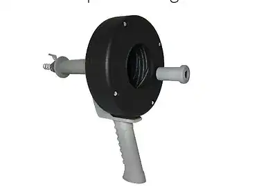

Get yourself a toilet snake. They consist of a long, spring like cable with a slightly larger end with an 'auger' type point. Mine has a plastic housing which holds about 3 - 5 feet of this spring and then 'feeds' it out as you rotate a handle.
To start you uncoil about 12 - 18 inches and work it down the drain and past the toilet bend. Then you rotate the spring while feeding more out and down into the drain. With some luck and patience, you should be able to dislodge the clog.
