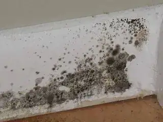

Mold-removing chemical products are good but the mold keeps growing back.
What is an efficient permanent solution?

Removing the cause of the problem rather than the problem itself is the only real solution to permanently remove mould .
For mould the usual culprit is moisture. In most cases the moisture will come from one of two places:
  • If the moisture is coming from the air (e.g. a steamy bathroom or a cold hallway) the problem is managed (perhaps not completely fixed) by removing moisture from the air. To remedy this you can try:
    • Use an electric dehumidifier (the little salt block ones simply aren't efficient enough)
    • Keep the area well ventilated, open windows and doors
    • Don't add moisture unnecessarily, e.g. use an extractor fan if cooking or showering generates a lot of steam.
  • If the moisture is coming through the walls, floor or ceiling, the problem is much more difficult and will probably require a professional damp proofing course.
You will also need to remove the mould completely to reduce the chance of spores multiplying again. The chemical sprays you use already are probably enough for this.

Black mold is caused by Stachybotrys (also known as "toxic black mold" in the US( and it's usually associated with poor indoor air quality that arises after fungal growth on water-damaged building materials and exposure can cause adverse health effects.
The worst-case scenario for homeowners is produced by consecutive episodes of water damage that promote fungal growth and mycotoxin synthesis, followed by drier conditions that facilitate the liberation of spores and hyphal fragments2003.
Remember that simply killing the mold with a biocide is not enough. It can grow on any substance (on wood, paper, carpet, and foods) and there is no practical way to eliminate all mold and mold spores in the indoor environment. The way to control indoor mold growth is to control moisture.
The first step is solving an indoor mold problem which is always stopping the source of moistureEPA:
  • Assess the area infected with mold, checking for any hidden mold.
  • Identify and permanently fix the source of the leaks or seepage (such as water problem) to prevent mold growth. Water leaks in pipes, around tubs and sinks and can provide a place for biological pollutants to grow.
Secondly get rid of mold it-self:
  • Clean and dry any damp or wet building materials and furnishings.
  • Clean mold off hard surfaces with water and detergent, and dry completely.
  • Clean all components of the HVAC system to ensure nothing becomes contaminated.
  • Remove any object/materials near the insulation system that may have been contaminated.
  • Use mold removal compositions (such as containing anionic surfactants and sodium hydroxide)US5783550
After removing mold, here are the things which can prevent mold keeps growing back:
  • Reduce indoor humidity (to 30-60%) to decrease mold growth. Use dehumidifiers and air conditioners (be sure that the appliances themselves don't become sources of biological pollutants).
  • Reduce the potential for condensation on cold surfaces on cold surfaces.
  • Be sure crawlspaces are well-ventilated.
  • Turn off certain appliances (such as humidifiers, kerosene heaters) if you notice moisture on windows and other surfaces. Or remove/dispose contaminated HVAC filter media.
  • Vent your clothes dryer to the outside.
  • Raise the temperature of cold surfaces where moisture condenses.
  • Increase air circulation.
    • Use exhaust fans (e.g. in bathrooms and kitchens) to remove moisture to the outside.
    • Move furniture from wall corners to promote air and heat circulation.
    • Keep open doors between rooms (especially to closets which are colder than other rooms) to increase circulation.
  • In areas where there is a perpetual moisture problem, do not install carpeting. It can absorb moisture and serve as a place for biological pollutants to grow.
  • If you have insulated air ducts and the insulation gets wet or moldy, it should be removed and replaced.
  • Consider replacing the insulation in the HVAC system with an external to prevent future floodwater contamination.
If above conditions causing the mold growth are not corrected, mold growth could recur.
In case where the area of mold is large you should hire a remediation manager to properly dispose of the mold or consult with a qualified professional.
