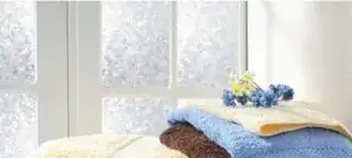

It is very usefull (and cheap btw) where nothing can be see through it by eyes, but sun (or light from another room) can pass it.
So we talking about privacy window films.
image iamge1
You can find it (in my country) almost on any bookstore. It so easy to set it up, or to remove when you don´t need it anymore.

  • Note that most of these are attached by applying a soap and water solution to the window, and then putting the privacy window film on top of this. This actually holds the film in place. Also note that if you don't want to buy privacy window film, this could possibly be achieved by using a non-transparent piece of thin plastic. – holroy Apr 19 '17 at 18:19
  • This is also widely available in hardware/home improvement stores and on Amazon. – Allison C Dec 20 '19 at 20:15

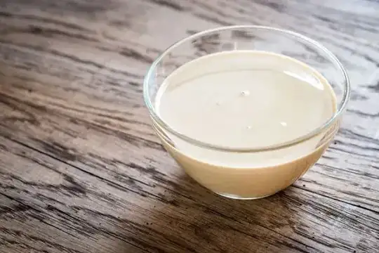

A Mexican recipe for home made glue, probably the cheapest reversible and multipurpose solution to your problem: (walls won't stop the peeping toms, but dirt cheap Mexican engrudo will!)
Engrudo
A traditional recipe for a non-toxic, biodegradable, DIY adhesive compound
Ingredients
  • 100g (~3.5oz) wheat or corn flour
  • 1 liter (~1/4 G) of cold water
  • 5 cc (2 tsp) of vinegar (or 2 teaspoons)
  • Optional: vegetable coloring of your choice.
Yields
About 1liter (1/4 Gallon) strong natural methylcellulose paste adhesive, non-toxic if accidentally ingested.
Preparation
In a pot, dissolve some of the flour in a little water until there is no lumps. Add some more water, then more flour untill both ingredients are fully mixed with no lumps (if you try to do it all in one go, you'll get a lumpy mess)
Bring the preparation to a low heat and stir with a wooden spoon. Continue stirring until it begins to boil, and at that point, remove from the heat. Let cool, add the vinegar and mix.
If desired, add a few drops of vegetable coloring of your choice.
Without coloring, the end product will be an off-white tacky paste, (yellowish color approximating the hue of the flour used). When applied to glass, it will behave as a light diffusing, translucent coating.

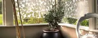

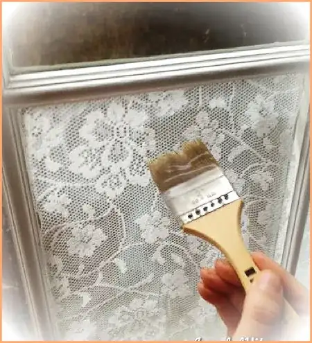

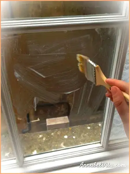

For this project, probably the best result will be using some
sort of light wide woven fabric, such as the emergency bandages you can
find on any first aid kit. A decorated tablecloth is also great idea (see pictures for what to expect of the finished project)
You can also use paper (very thin) for translucent effect or even leaves and cutouts such as depicted on other answers in this thread.
You'll need enough to cover the surface of the glass to be privacy- enhanced. Just soak the bandages or paper on the engrudo, saturating them. Then apply and spread over the glass.
Use a wide paintbrush to apply, or, if you know how to handle them, you > can use a spatula to even out the fabric or eliminate bubbles.
Applying first coat on glass, applying a decorated tablecloth, creative application of cheap old newspapers on glass:
Let it sit on a well aired room. Curing times are comparable to commercial white glue. May vary depending on the grain of the flour used (coarse = slower fine = faster) but YMMV.

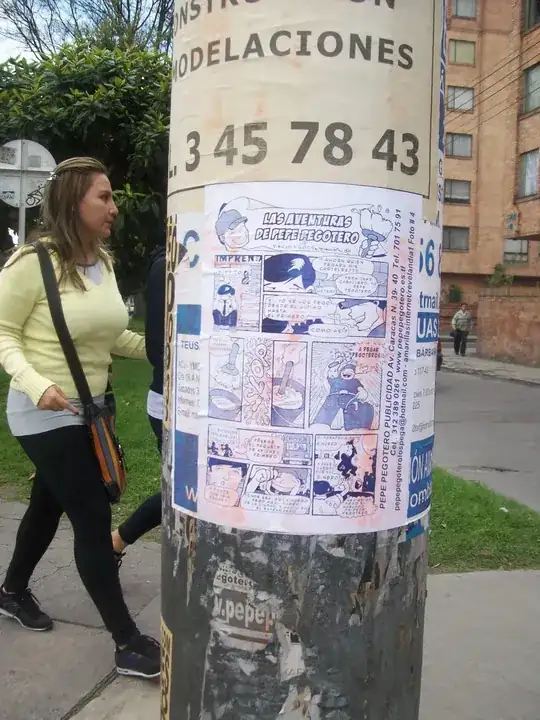

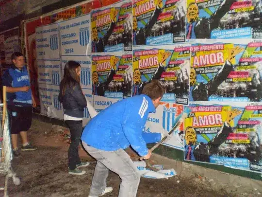

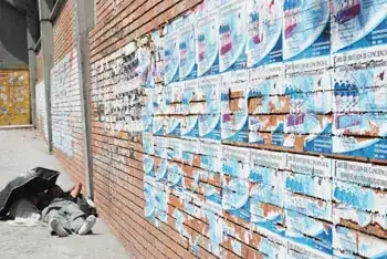

A slightly lighter mixture of engrudo (diluted with a bit more water for larger yield, increasing absorption on paper), Is still used to soak printed kraft paper posters on it, and then applying to walls/masonry on public buildings for advertising purposes.
It's applied using a long paintbrush resembling a broom, taking the just soaked on engrudo poster and spreading it out on the wall surface. Engrudo will bond with the masonry, trough the porous paper and the end result is a nearly indestructible advertisement. Wooden telephone posts are used for this purpose too, with subsequent applications taking advantage of the substrate created by older layers of engrudo soaked posters. (Just apply the new poster on top of the older ones.)
I've seen maintenance crews sandblasting old advertising affixed to churches and public building walls using this technique.
Examples of nearly indestructible advertising:
