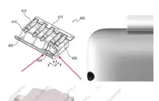

While researching more on SO, I found the following image on this thread.
Headphone Jack Diagram
There are 2 possibilities :
  1. The plastic ball's diameter is bigger than the end of the tube and it is stuck before the point where the tube gets narrow (at point just before 404).
  2. The diameter of the ball is small and it has reached the end of the tube (in the narrower region, marked by right red arrow).
(To determine the case, then you can try shaking your laptop and holding it close to your ears. If you can hear a slight sound, then it's probably case 2, else its stuck at case 1.
You said you tried with a toothpick and glue, and it didn't work. This suggests that it might be the second case.)
In both cases however, you can take a needle and try to poke and break the ball into pieces. Broken pieces might fallout then.
Precaution : This might damage the internals of your laptop. Proceed at your own risk.

  • Breaking up the ball into smaller pieces makes those smaller pieces likely to lodge in the port -- not sure that would make things worse, in this case, but it's unlikely (IMO) to solve the problem. A version of this that might actually work is to use a straightened fish hook; push the barbed point through the ball, and it'll capture the ball and let you pull it out. Down side is, if you damage the socket, you void your warranty and you're back to taking the computer to the Apple Store. – Zeiss Ikon Sep 30 '16 at 11:16
    The image shows there's a series of obstructions in the port (the pins sticking out). If you can break up the ball, the pieces will have a diameter smaller than the clearance between the pin and the opposite wall of the socket, making it more likely the pieces can be removed. – Hobbes Sep 30 '16 at 13:05
  • @Hobbes I agree that the smaller pieces will probably come out because they won't be wedged in like the ball is currently. (That was my answer to this!) But Zeiss Ikon, that fishing hook idea is pretty great! – BrettFromLA Sep 30 '16 at 18:19
