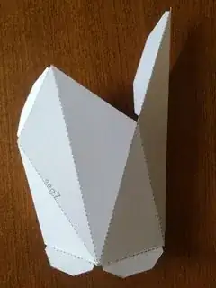

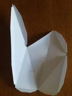

I printed out some schematics onto 210gsm paper (our printer is a HP Laserjet P2035). The ink and toner has struggled to take to the paper. Now as I have been working on cutting out these shapes, the original ink is rubbing off to some extent and it is creating smudges on the reverse of the paper, either from my matt cutter or my hands (much like newspaper print).
So of course the question is which is the best method to attempt to remove these smudges.
Photos of front and reverse for referece:
model1 model2

A normal white plastic eraser should do the trick. As you pointed out, the ink is already smudging so any reasonable effort to remove it will work. Make sure to keep the eraser clean to avoid working the toner into the paper surface.
Another possibility would be to apply a thin layer of paper (rubber) cement over the smudges. After it dries, use a natural rubber pick-up square (sometimes called a mouse) to remove the cement and smudges.
It contains no water so it will not distort the paper. It dries quickly. Note: Do not use "one-coat" cement which will be more difficult to remove if not impossible. I use "Best-Test" brand paper cement. A small bottle comes with its own brush applicator.
A third possibility would be to use a very sharp knife such as a single-edge razor blade or x-acto knife (with #10 General Purpose blade which is curved to avoid gouging or cutting the surface). Use the appropriate blade nearly perpendicular to the surface to gently scrape the toner off the paper. Pull the blade toward you lightly and repeatedly until the mark is gone. This is a make-shift knife eraser that is used on parchment and other such surfaces. When done properly, there is little or no trace of the mark on the piece.
Note that the knife eraser needs a bit of attention when used on folds, creases, or scores that make the surface uneven.
