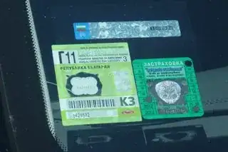

How to remove a sticker from the inside of a car windshield which I want to leave undamaged so that it can be used on another car. The stickers are for car insurance, road tax (vignette) or other similar.
Lets say if they were applied on the wrong place or the wrong car and I want to move them, then I need to take them without damaging.

If it is a plastic sticker, try to heat up the window from the other side of the sticker so it becomes somewhat loose, then you can gently peel it off and it should come right off.
However, if it is a paper based sticker you will not have much luck since those are really fragile. If you want to clean your window completely (ruining the stickers) I would suggest using a screen cleaner foam and a razor. Soak the sticker with the foam and without applying too much pressure on the windshield (don't scratch it) use a razor blade to peel it off.

This process has worked well for me:
  1. Heat the sticker with a hot air dryer to loosen the adhesive.
  2. Insert the tip of a razor blade under one corner of the sticker.
  3. Work the blade behind the sticker about 1/4 inch.
  4. Press the loosened portion of the sticker against the flat side of the blade, then lift the blade and sticker together (slowly). If the sticker starts to tear, reheat and start another corner.
  5. Use Goof Off, acetone, or another solvent to remove residue from glass.
  6. Use contact adhesive if needed to improve adhesion to the new surface.
The warmer and softer the adhesive, the better the end result.
