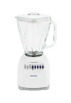

How can I reduce or eliminate sound coming from high speed blender (a normal, common, 10 speed Osterizer blender)
A normal Osterizer blender
