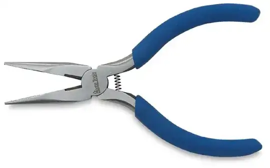

    For ANY method using electrically conductive tools (potatoes, pliers like the ones below where you can easily slip forward onto bare metal), either: a) Make sure light fixture is physically disconnected by fuse or plug, or b) make sure (measure with a voltmeter that you positively tested on a live socket) there is no dangerous voltage relative to earth on ANY contact in the light socket. If that can't be done - well I cannot recommend using insulated tools, gloves and shoes since that is stuff diy'ers arent supposed to do under most codes :) – rackandboneman Dec 28 '15 at 21:25

Put the jaws of pliers into the socket and force the handles apart to grip the inside of the socket. Turn the pliers to back out the bulb.
If the friction is not strong enough to turn the base of the bulb, you can wrap the jaws with a rubber band first.
James
  • 1,864
  • +1 because this works - these pliers can also grab into the rim easily. – rackandboneman Dec 28 '15 at 21:23
