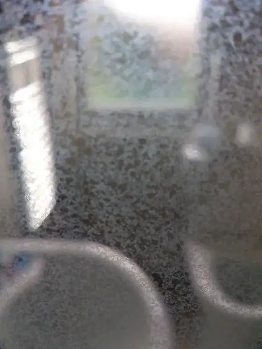

Discoloured shower door
My shower door has slowly built-up this limescale-like coating over the past 5 years and it does not seem to respond to any attempt to remove it.
It is far more prevalent on the door nearest the shower outlet so it would seem to be simple limescale. However, we have a water softener so the carbonate content of the water should be very low indeed. Also, I have tried using limescale treatment chemicals and they don't work, so this would appear to be something different.
Any suggestions please - or am I wrong and this is ordinary limescale and I'm not treating it properly?
UPDATE: Over 3 years later and I am yet to find a practical answer to this problem. However, I have an update that may be of interest.
On the advice of a couple of the answers, I have finally tried to use steel wool. I can report that
1. This does NOT scratch the glass and
2. It DOES abrade the scale build-up - albeit requiring FAR too much time and effort to be practical.
About 10 minutes of polishing removed around 20% of the scale in 6 square inches of the glass. Enough to see that an effect was being achieved - but also to tell me that a better method is needed. I wasn't using any liquid cleaner, just dry steel wool. Another test beckons....

  • Hi @lefty did you manage to get rid of the limescale? did the caustic soda solution work? – Michael Le Nov 29 '18 at 11:35
  • @MichaelLe No, it didn't. I tried a few different things but gave up when none of them worked. – Lefty Dec 09 '18 at 22:39
  • It would be useful for others if you added a list of what you tried that didn't work. – piojo Jan 03 '20 at 04:37
    @piojo Yes, good idea. I will have to do that when I get a chance. It has been 4 years, so it will take some thinking about... – Lefty Jan 03 '20 at 08:02
  • @Lefty Yeah, the question just popped up for some reason, and I got to wondering :) – piojo Jan 03 '20 at 08:08

From what I could see in a well focused portion of the image you had posted
there is a diffraction of light at the rims of the "stains". This would not be expected from ordinary limescale but indicates that the surface of your door was damaged.
This may come from an aged surface coating or from acrylic glass of your door. This may also be the result of treating the coating, or acrylic glass with a cleaner capable of partly dissolving it.
To avoid replacing the door we can hide the stains by applying a frosted or etched glass film. Transparency will be lost by this.
Takkat
  • 4,726
  • Nice idea, but I don't think so. The door is about 8 years old and the problem didn't really materialise until about the 3rd year. It has got worse continually since then. Both doors are cleaned the same way but this one is much worse than the other. – Lefty Dec 20 '15 at 15:07
    To confirm that this is etching, you could take a straight-edge razor and scrap it. If it comes off, it's precipitate of some sort, if not, there won't be a simple way to fix it and @Takkat's idea stands as a good idea. – Minnow Dec 20 '15 at 17:12
    @Minnow I've tried scraping it with a razor scraper and it does scrape off but is very, very, hard. – Lefty Dec 20 '15 at 18:09
  • @Lefty: it still could be some coating or a protective film that came off. – Takkat Dec 20 '15 at 19:39
  • @Takkat No, it's not. The build-up is most prevalent on the areas where water hits it most often. For instance, the top of the door is almost completely clear. I'm prepared to concede that it may be a result of soap/shampoo contacting the glass in those areas - but it's not a coating that came off. – Lefty Dec 20 '15 at 19:44

After a good night's sleep I came up with another idea:
Try applying a thin film of lacquer. Do this only: - after you properly clean the surface; - after you test it on a small "hidden" surface.
Different lacquers might have different effects.
I just realized: you already tried a lot of things. The surface is probably cleaner that it should be :D
This idea - to apply rather than to remove - might be your solution. Especially after I looked again at the last picture.
virolino
  • 2,640
@Lefty, I had a sliding glass shower door with the same water scaling issue and have looked for years for a solution. I just found one today that completely took it off and it looks brand new. I wish I would have taken pictures to show the before and after but I was just so excited to have finally found a solution.
I used WEIMAN Glass Cook Top Cleaner and Polish. I squirted it on the scrubbing side of a Scotch-Brite Stay Clean Scrubber. I used elbow grease to really scrub a 1.5 foot square area. Then used paper towel wipe most of it off and another clean paper towel to buff it completely off. The scaling was gone and clean glass looked like new. I continued the same procedure to do the entire door. Took about an hour to do both doors but now they look like they did when they were installed. Hope it works for you.
SWood
    My guess is that your WEIMAN product is similar to the "Hob-Brite" product that I mention in response to one of the other answers. I originally bought it to clean my ceramic hob and it is a bit of a cocktail of cleaning agents but with a fine abrasive added. When used (WITH steel wool) it had some effect, but not enough to really be practical, unfortunately! – Lefty Jan 02 '20 at 11:15
