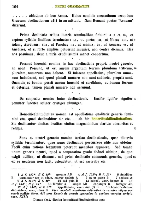

First of all, with all due respect, this word is not Classical Latin; it’s a Medieval Latin neologism (a nonce word) that was occasionally used solely because of its length.
Secondly, honorificabilitudinitatibus is technically a word form, not a word (i.e. it’s not a lexeme).
Afaik, it is first encountered in a treatise written by Peter of Pisa, an eighth century Italian grammarian, who, incidentally, taught Latin to Charlemagne.
Here’s the screenshot:
