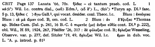

Bonus: All Voigt has on this fragment
Voigt part 1
Voigt part 2

  • The verb form you’re jnterested in so much, is it in Campbell or Voigt? I don’t think so. – Alex B. Aug 16 '18 at 17:07
  • @AlexB Voigt adopts épsyxas, but mentions Wilamowitz suggested éphlyxas. Campbell follows Voigt but without the mention of éphlyxas. – MickG Aug 16 '18 at 17:13
  • I figured as much. But what does Voigt say about it? It could be important. – Alex B. Aug 17 '18 at 02:16
  • @AlexB. I added the whole Voigt part about this fragment. All I can see about the form is «ἔφλυξας Wil. l.c.», where Wil. must stand for Wilamowitz, and l.c.… locus citatus? Or maybe it's an edition and the abbreviation is explained elsewhere? – MickG Aug 17 '18 at 11:10
  • Conspectus compendiorum has no such edition, but in the TEST we have «Wil., TGBuk. 179», where I guess the number is a page number and the rest is in the conspectus compendiorum explained as «U. v. Wilamowitz-M., Die Textgeschichte der griechschen Bukoliker (Philol. Unters. 18). Bl. 1906». – MickG Aug 17 '18 at 11:23
  • I guess it's that book, and l.c. stands for liber citatus. – MickG Aug 17 '18 at 11:25
